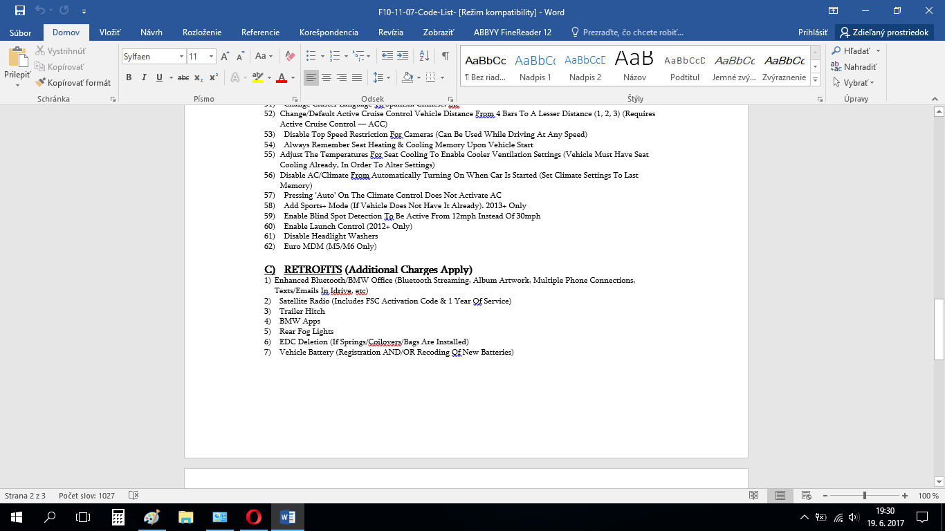

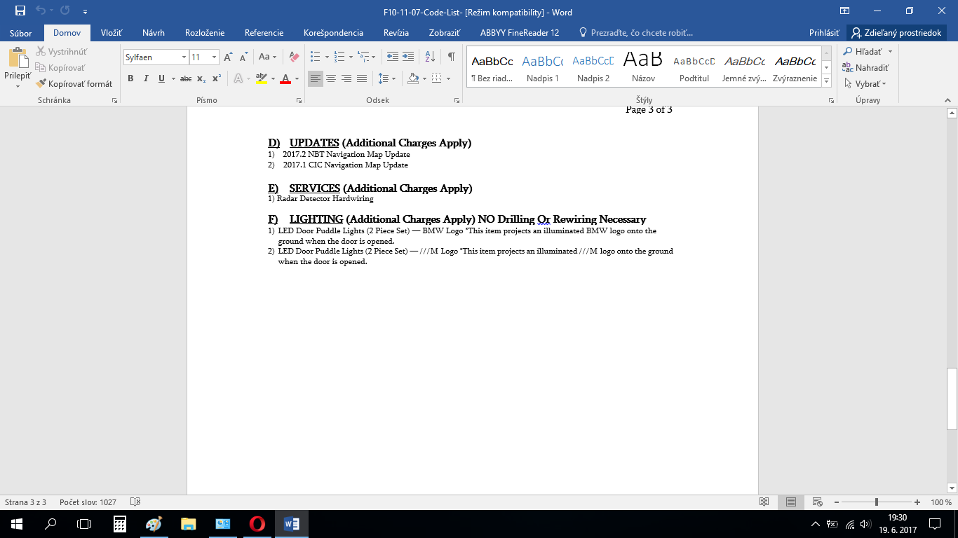

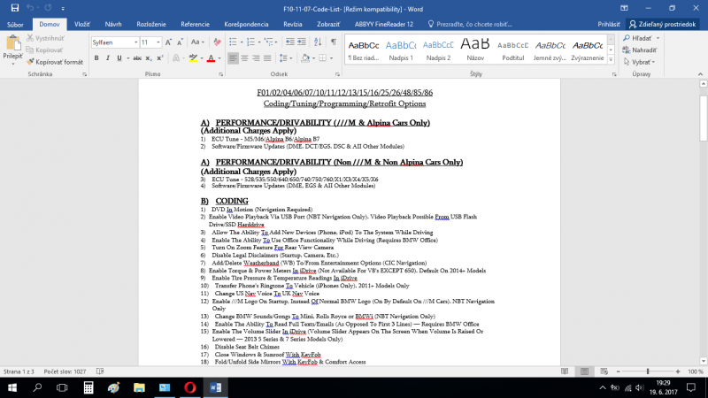

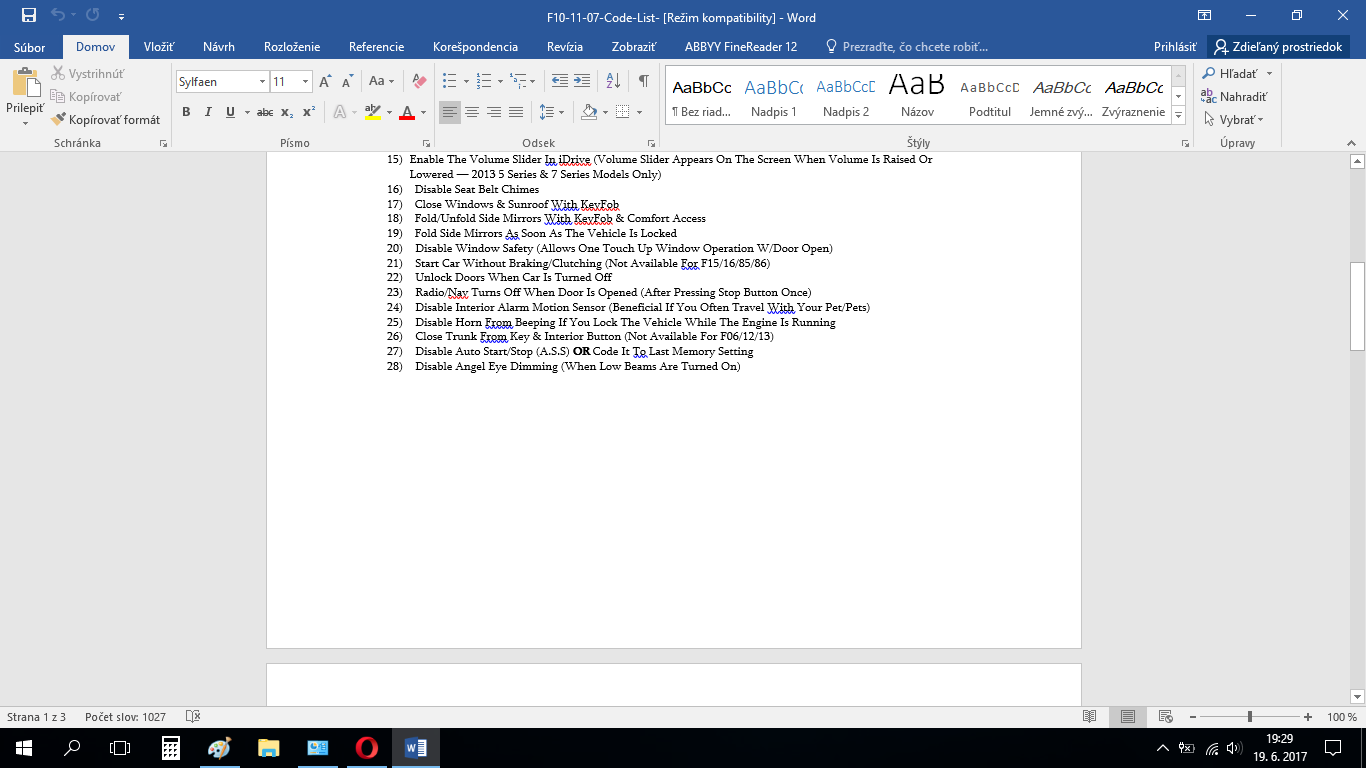

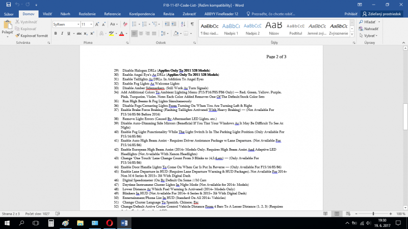

PristineShip nie do e46 da to neda !!! :D tak tak 6AR Internet funguje to navjiac na NBT :) da s aurobiť wifi hotspod ale je to komplikovane . BMW apps alebo cez mobilne data internet . tušim že su tam 2 veci online webrowser a online webrovser live Enable WiFi Hot-Spot
wifi Enable WiFi Hot-Spot
(Need to install a DLNA/UPnP media sharing server on your laptop or phone to be able to use this)
3000àENT_MC_WLAN_STREAM_DMP_COVERART set to: aktiv
3000àENT_MC_WLAN_STREAM_DMP_VIDEO set to: aktiv
3000àENT_MC_WLAN_STREAM_DMP set to: aktiv
3003àWLAN_STATUS set to: aktiv
3003àWLAN_MODUS set to: ap
3003[font=Wingdings]àWLAN_SIGNAL_STRENGTH set to: outdoor[/font]
viewing HTML emails in Browser supported
v F modeloch je to tak že len 10% je preskumanich a vždy sa aktulizuju :) a tých 10% je toho vela :)
F01/02/04/06/07/10/11/12/13/15/16/25/26/48/85/86 Coding/Tuning/Programming/Retrofit Options A) PERFORMANCE/DRIVABILITY (///M & Alpina Cars Only) (Additional Charges Apply) 1) ECU Tune – M5/M6/Alpina B6/Alpina B7 2) Software/Firmware Updates (DME, DCT/EGS, DSC & All Other Modules) A) PERFORMANCE/DRIVABILITY (Non ///M & Non Alpina Cars Only) (Additional Charges Apply) 3) ECU Tune – 528/535/550/640/650/740/750/760/X1/X3/X4/X5/X6 4) Software/Firmware Updates (DME, EGS & All Other Modules) B) CODING 1) DVD In Motion (Navigation Required) 2) Enable Video Playback Via USB Port (NBT Navigation Only). Video Playback Possible From USB Flash Drive/SSD Harddrive 3) Allow The Ability To Add New Devices (Phone, iPod) To The System While Driving 4) Enable The Ability To Use Office Functionality While Driving (Requires BMW Office) 5) Turn On Zoom Feature For Rear View Camera 6) Disable Legal Disclaimers (Startup, Camera, Etc.) 7) Add/Delete Weatherband (WB) To/From Entertainment Options (CIC Navigation) 8) Enable Torque & Power Meters In iDrive (Not Available For V8’s EXCEPT 650). Default On 2014+ Models 9) Enable Tire Pressure & Temperature Readings In iDrive 10) Transfer Phone’s Ringtone To Vehicle (iPhones Only). 2011+ Models Only 11) Change US Nav Voice To UK Nav Voice 12) Enable ///M Logo On Startup, Instead Of Normal BMW Logo (On By Default On ///M Cars). NBT Navigation Only 13) Change BMW Sounds/Gongs To Mini, Rolls Royce or BMWi (NBT Navigation Only) 14) Enable The Ability To Read Full Texts/Emails (As Opposed To First 3 Lines) – Requires BMW Office 15) Enable The Volume Slider In iDrive (Volume Slider Appears On The Screen When Volume Is Raised Or Lowered – 2013 5 Series & 7 Series Models Only) 16) Disable Seat Belt Chimes 17) Close Windows & Sunroof With KeyFob 18) Fold/Unfold Side Mirrors With KeyFob & Comfort Access 19) Fold Side Mirrors As Soon As The Vehicle Is Locked 20) Disable Window Safety (Allows One Touch Up Window Operation W/Door Open) 21) Start Car Without Braking/Clutching (Not Available For F15/16/85/86) 22) Unlock Doors When Car Is Turned Off 23) Radio/Nav Turns Off When Door Is Opened (After Pressing Stop Button Once) 24) Disable Interior Alarm Motion Sensor (Beneficial If You Often Travel With Your Pet/Pets) 25) Disable Horn From Beeping If You Lock The Vehicle While The Engine Is Running 26) Close Trunk From Key & Interior Button (Not Available For F06/12/13) 27) Disable Auto Start/Stop (A.S.S) OR Code It To Last Memory Setting 28) Disable Angel Eye Dimming (When Low Beams Are Turned On)
29) Disable Halogen DRLs (Applies Only To 2011 528 Models) 30) Enable Angel Eye’s As DRLs (Applies Only To 2011 528 Models) 31) Enable Taillights As DRLs, In Addition To Angel Eyes 32) Enable Fog Lights As Welcome Lights 33) Disable Amber Sidemarkers, (Still Work As Turn Signals) 34) Add Additional Colors To Ambient Lighting Menu (F15/F16/F85/F86 Only) – Red, Green, Yellow, Purple, Pink, Turquoise, Violet. Note: Each Color Added Removes One Of The Default/Stock Color Sets 35) Run High Beams & Fog Lights Simultaneously 36) Disable Fogs/Cornering Lights From Turning On When You Are Turning Left & Right 37) Enable Brake Force Braking (Flashing Taillights Activated With Heavy Braking) – (Not Available For F15/16/85/86 Before 2016) 38) Remove Light Errors (Caused By Aftermarket LED Lights, etc.) 39) Disable Auto-Dimming Side Mirrors (Beneficial If You Tint Your Windows As It May Be Difficult To See At Night) 40) Enable Fog Light Functionality While The Light Switch Is In The Parking Light Position (Only Available For F15/16/85/86) 41) Enable Auto High Beam Assist - Requires Driver Assistance Package w/Lane Departure. (Not Available For F15/16/85/86) 42) Enable European High Beam Assist (2014+ Models Only. Requires High Beam Assist And Adaptive LED Headlights (Not Available With Xenon Headlights) 43) Change ‘One Touch’ Lane Change Count From 3 Blinks to (4,5,6,etc) – (Only Available For F15/16/85/86) 44) Enable Door Handle Lights To Come On When Car Is Put In Reverse – (Only Available For F15/16/85/86) 45) Enable Lane Departure in HUD (Requires Lane Departure Warning & HUD Packages). Not Available For 2014+ Non M 6 Series & 2015+ X6 With Digital Dash 46) Digital Speedometer (On By Default On Some ///M Cars 47) Daytime Instrument Cluster Lights In Night Mode (Not Available for 2014+ Models) 48) Lower Distance At Which Fuel Warning Is Activated (2014+ Models Only) 49) Blinkers In HUD (Not Available For 2014+ 6 Series & 2015+ X6 With Digital Dash) 50) Entertainment/Phone List In HUD (Standard On All 2014+ Vehicles) 51) Change Cluster Language To Spanish, Chinese, Etc 52) Change/Default Active Cruise Control Vehicle Distance From 4 Bars To A Lesser Distance (1, 2, 3) (Requires Active Cruise Control – ACC) 53) Disable Top Speed Restriction For Cameras (Can Be Used While Driving At Any Speed) 54) Always Remember Seat Heating & Cooling Memory Upon Vehicle Start 55) Adjust The Temperatures For Seat Cooling To Enable Cooler Ventilation Settings (Vehicle Must Have Seat Cooling Already, In Order To Alter Settings) 56) Disable AC/Climate From Automatically Turning On When Car Is Started (Set Climate Settings To Last Memory) 57) Pressing ‘Auto’ On The Climate Control Does Not Activate AC 58) Add Sports+ Mode (If Vehicle Does Not Have It Already). 2013+ Only 59) Enable Blind Spot Detection To Be Active From 12mph Instead Of 30mph 60) Enable Launch Control (2012+ Only) 61) Disable Headlight Washers 62) Euro MDM (M5/M6 Only) C) RETROFITS (Additional Charges Apply) 1) Enhanced Bluetooth/BMW Office (Bluetooth Streaming, Album Artwork, Multiple Phone Connections, Texts/Emails In Idrive, etc) 2) Satellite Radio (Includes FSC Activation Code & 1 Year Of Service) 3) Trailer Hitch 4) BMW Apps 5) Rear Fog Lights 6) EDC Deletion (If Springs/Coilovers/Bags Are Installed) 7) Vehicle Battery (Registration AND/OR Recoding Of New Batteries)
