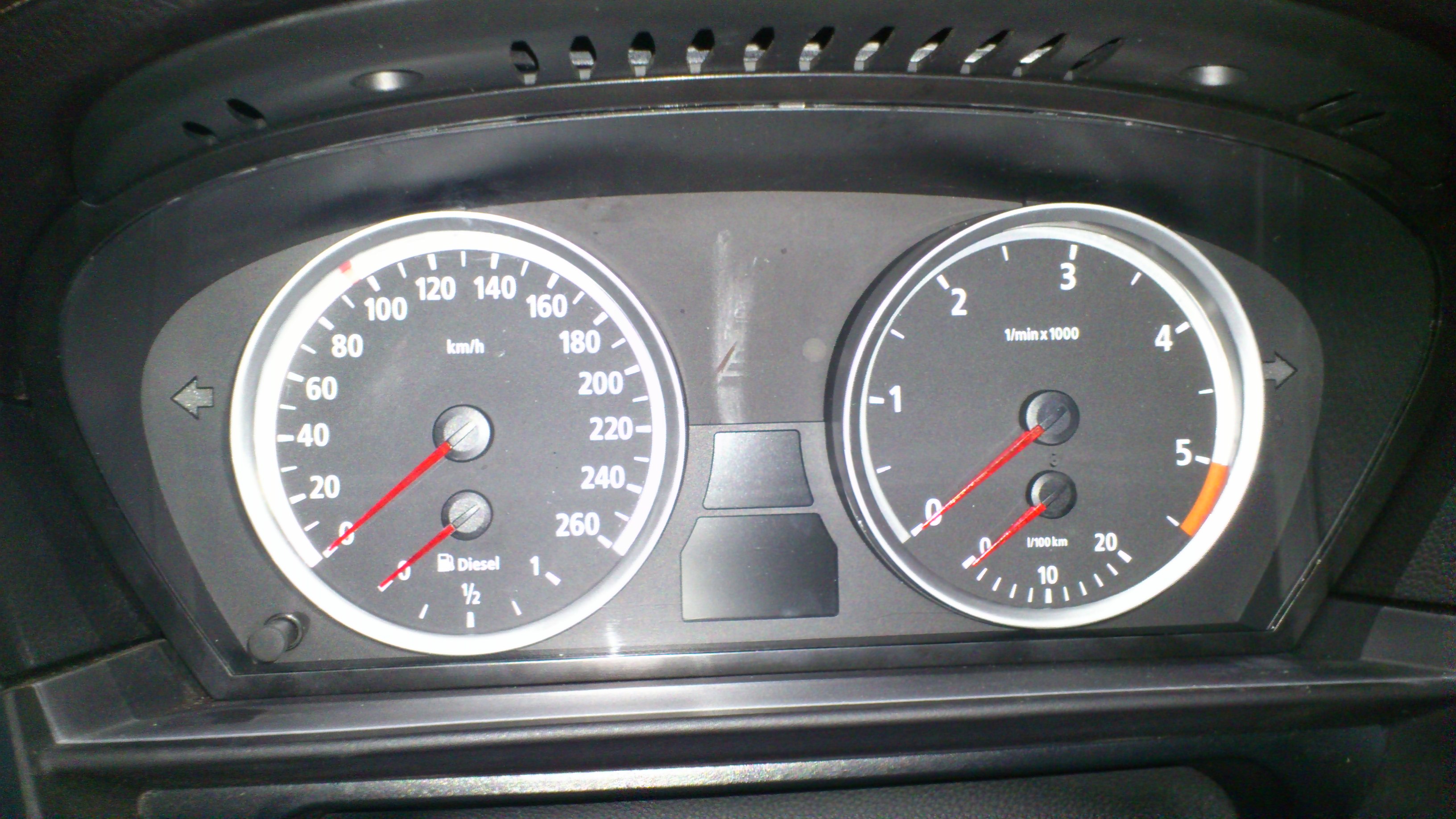

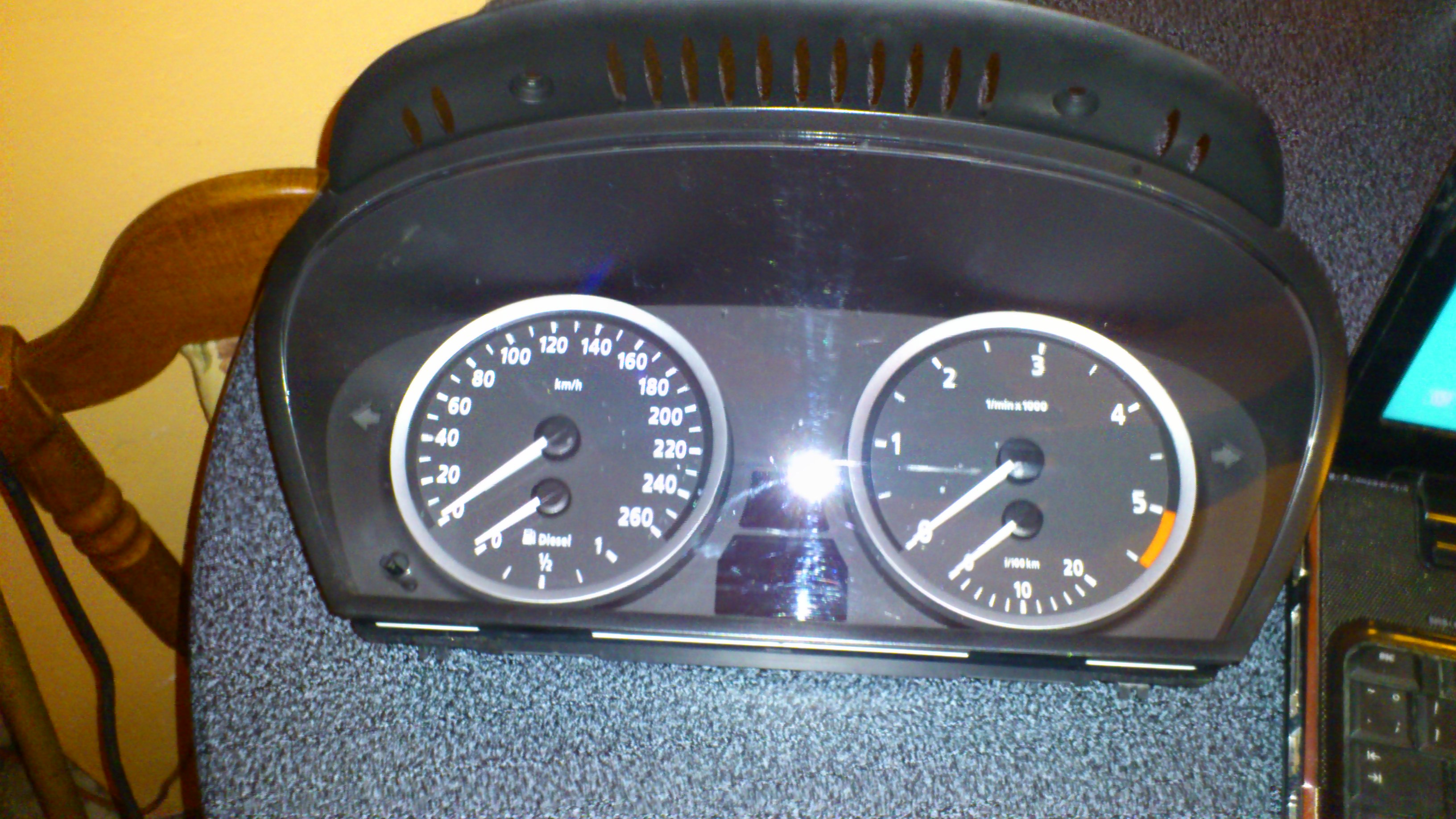

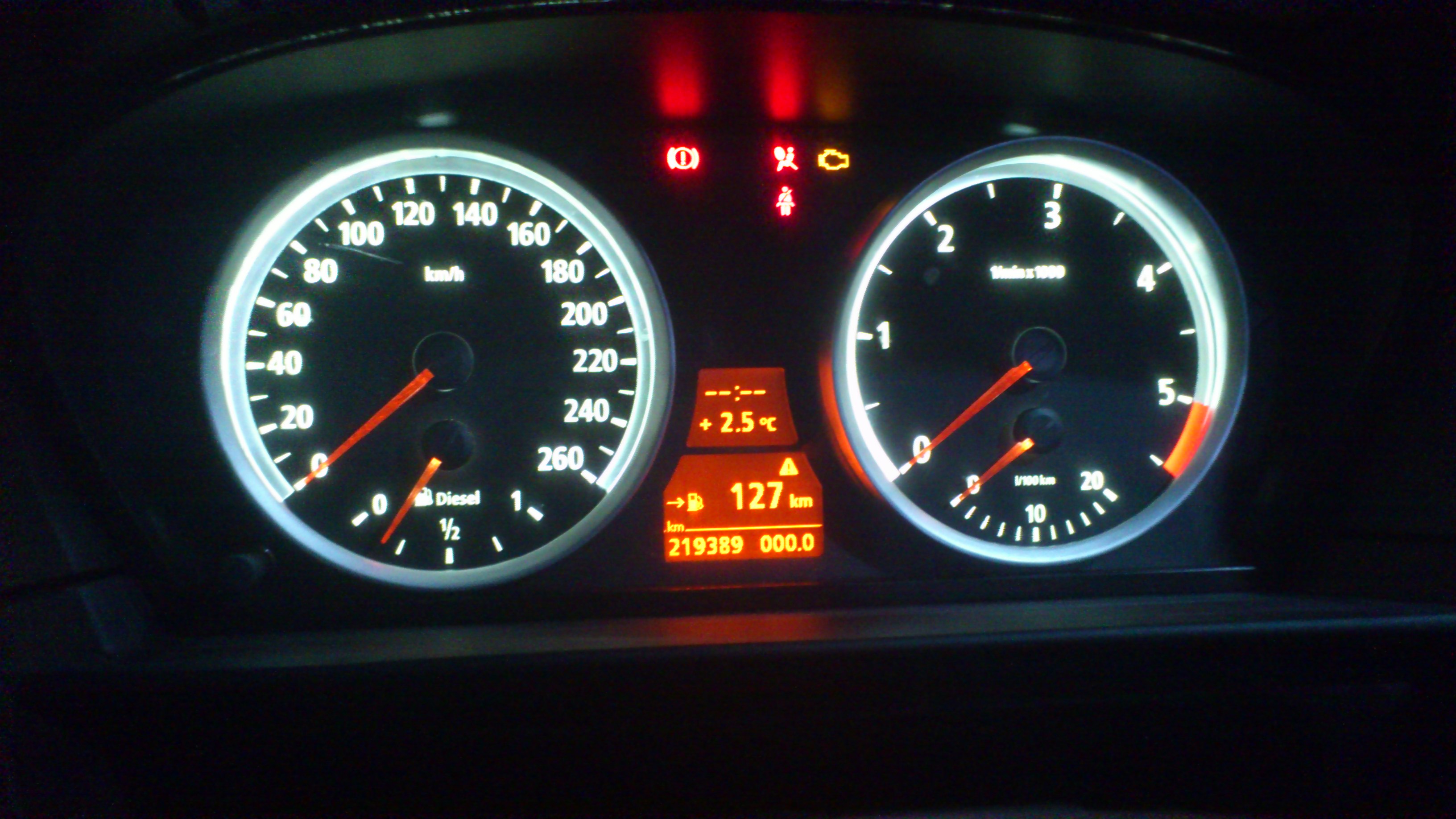

Kedze mi casto vypisuju ludia (dokonca mi aj volaju ked vidia na autobazari ze mam biele budiky) ze ako som to spravil a tak, a stale im poslem link na 5series forum lenze nikto sa tam akosi nevie registrovat tak davam sem navod ako sa to robi.
Podotykam ze navod je prevzaty takze to nie su fotky odo mna :wink:
Vela stastia

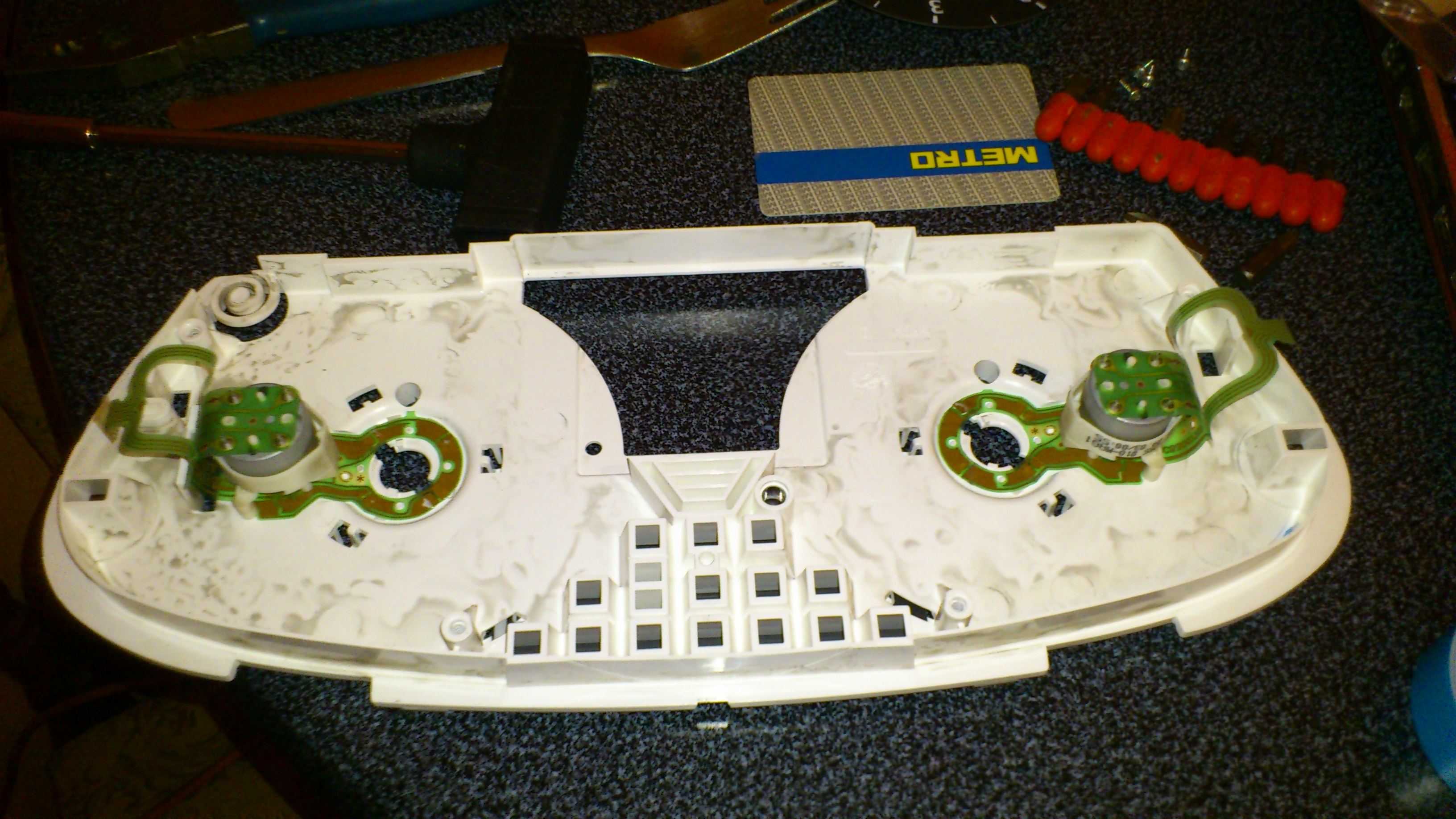

1st thing to do is unplug the battery.
01. Before the change.
02. There are 2 screws at the top which need to be undone to take out the cluster.
03. At the back there is a plug which need to take off.
04. Undo these 4 screws with a T10 screw driver
05. Undo the 4 clips by pushing it down and out.
06. Undo the 2 clips, then take off the casing.
07. Use a card and a fork to take off the needles, don't use too much force cos they will brake very easy.
08. At the back turn the plastic ring in the center clockwise to undo the ring and panel.
09. Undo the 2 screws with a T9 screw driver.
10. Take off the gear for the Cruise Control ring and rev ring.
11. You will see the 4 LEDs in each of the ring.
12. At the back. The board is fixed to a socket so just undo the board by pulling it up slowly.
13. Take out the LED board.
14. You will see 4 LEDs on each ring.
15. Use a solder iron to take off the old LEDs .
16. For the new 1s you will need 8 white LEDs. Solder the new white LEDs back on. Each ring will need 4 LEDs. On each led legs there will be a + and - for the power so get a multi meter to test which is which. If solder wrongly it will not light up.
17. On the white case use some double sided tape to sick down the board coz if not the board will not stay in place.

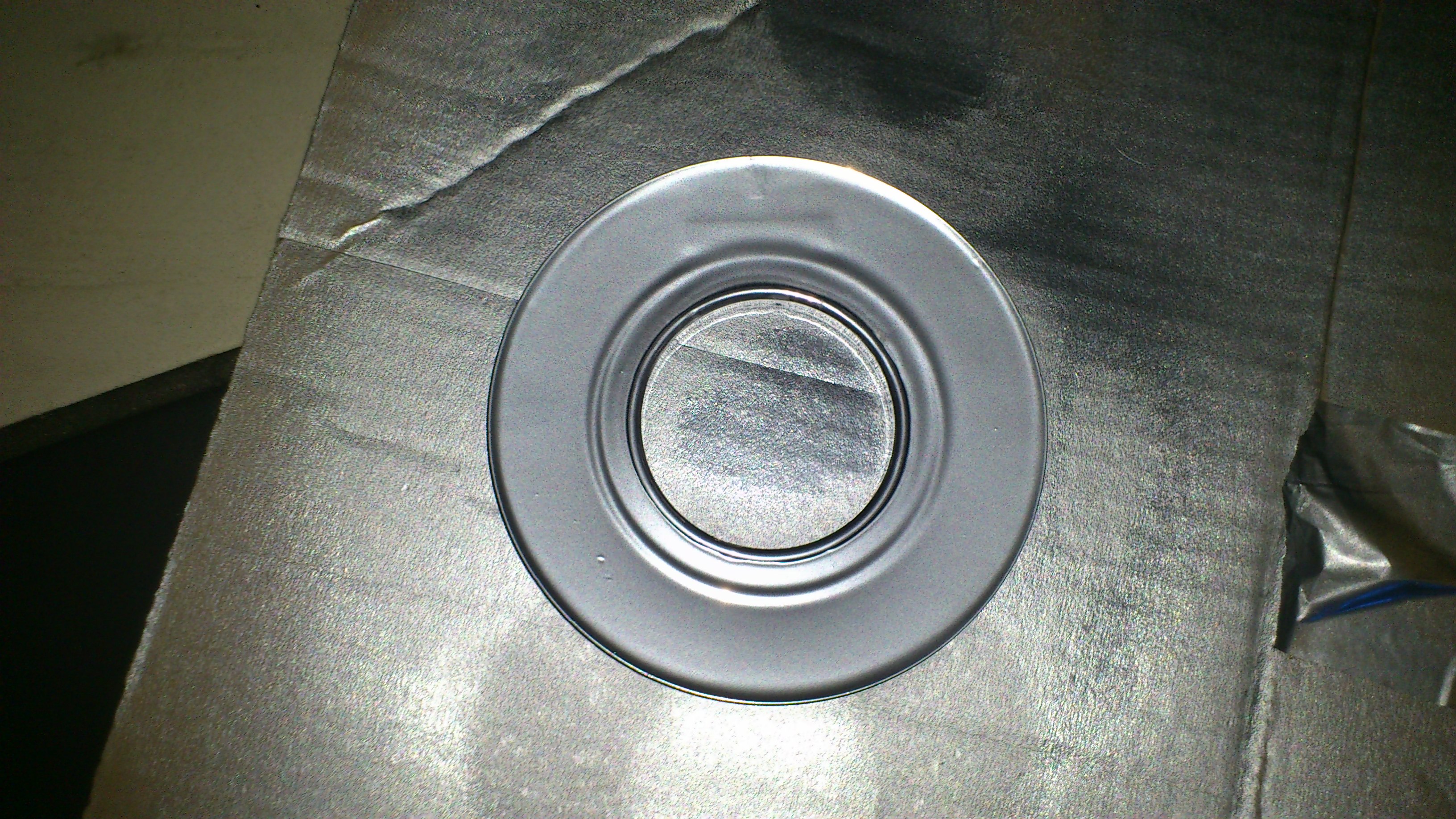

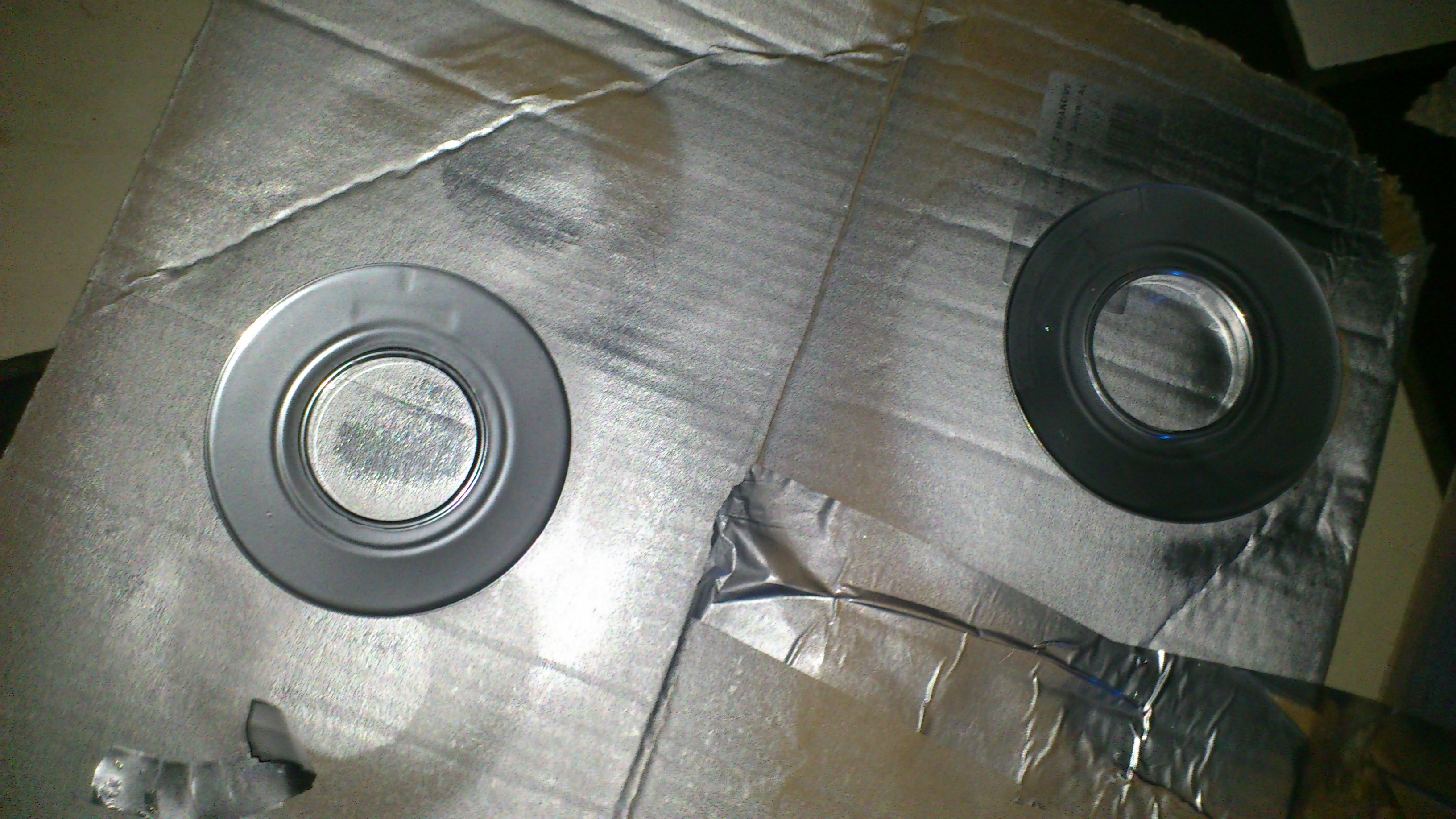

18. Spray the ring which ever colour you like.

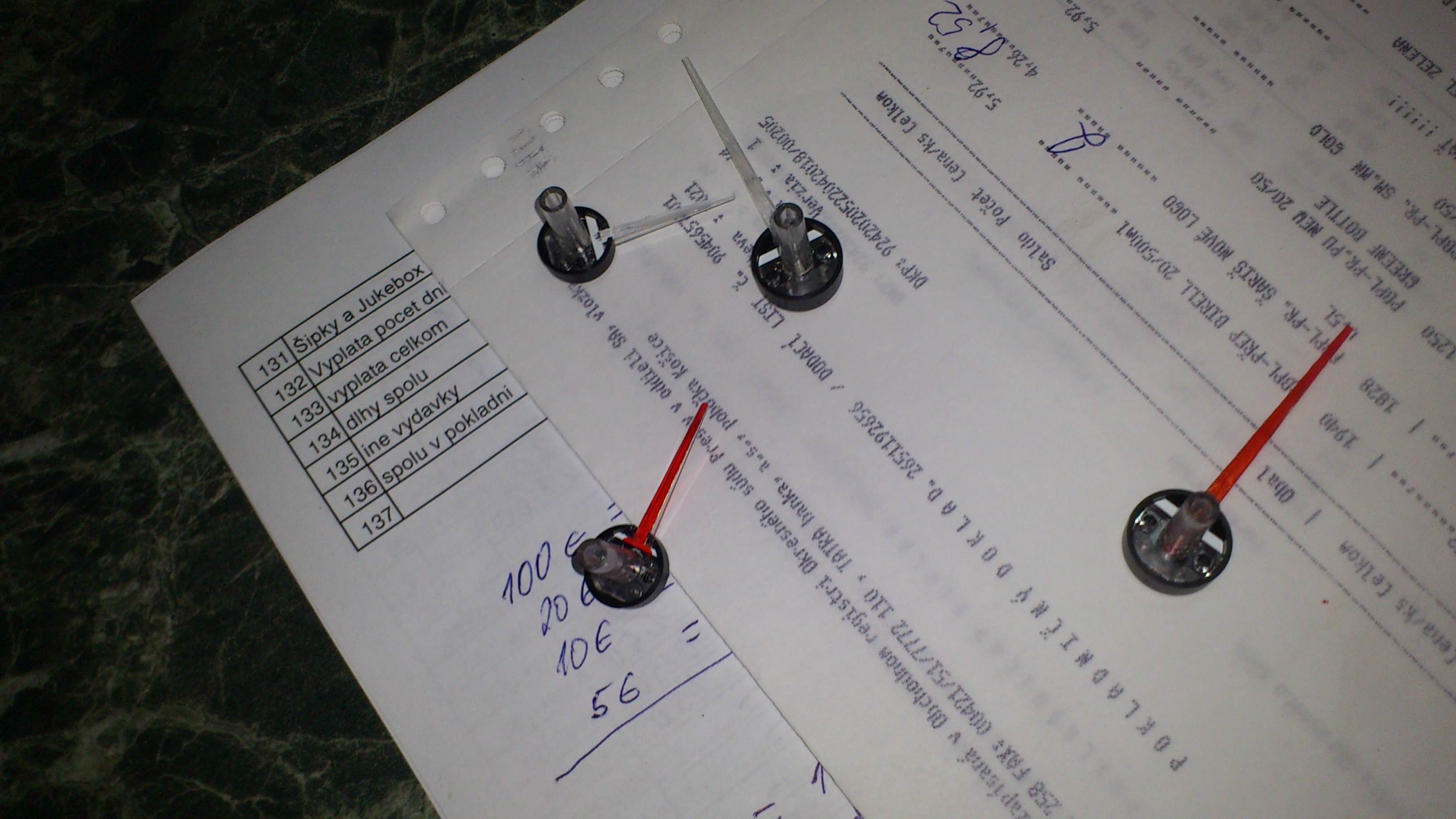

19. For the needle paint them red.
20. There you go finished here is the end product.

Ked niekto nema aspon ake take skusenosti, urcite by som odporucil nepustat sa do toho
A ked cervene rucicky, tak z m5. Tie maju v strede cierny pruh. Podla mna vyzeraju krajsie, ako celocervene

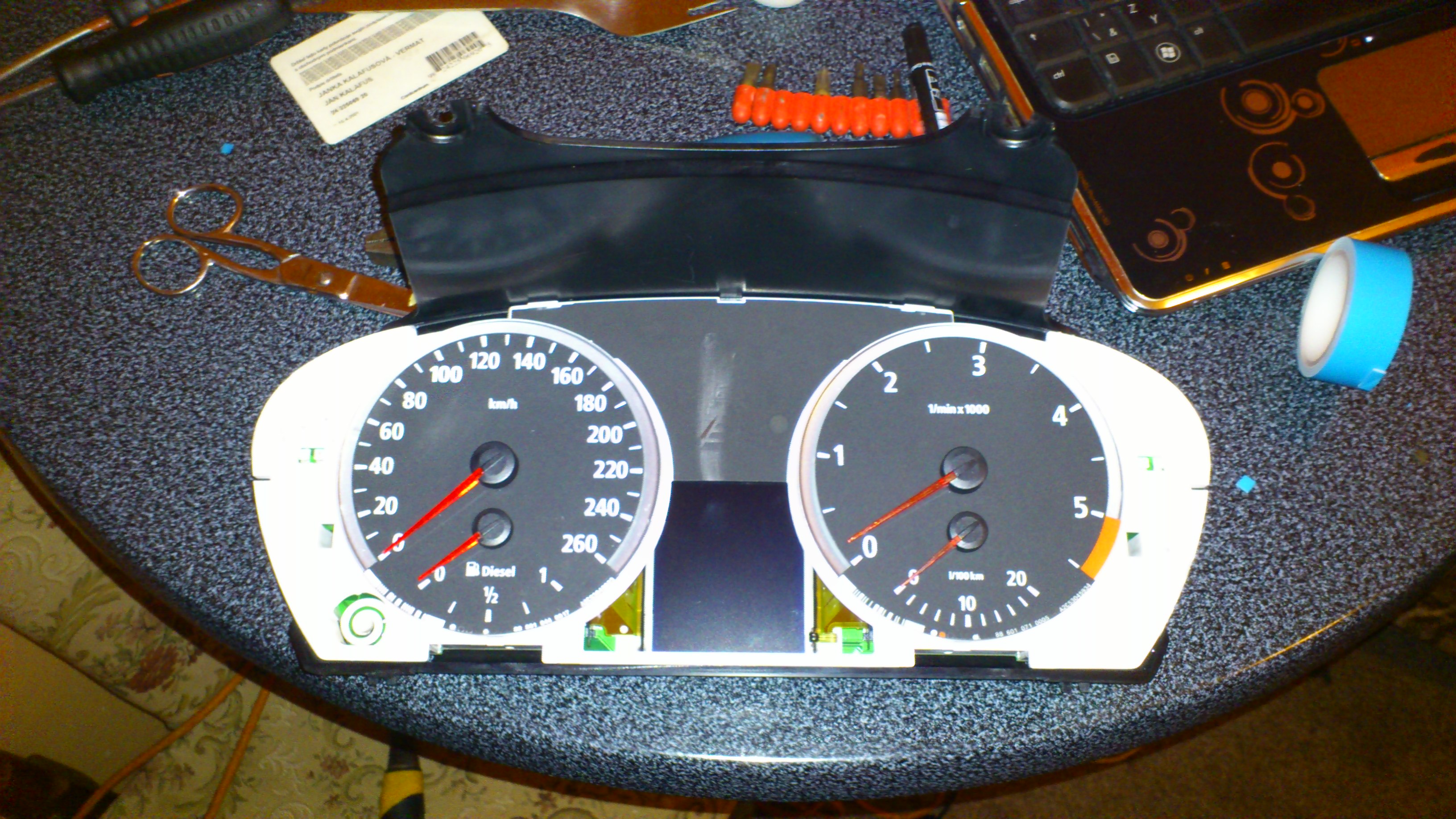

+ nieco z mojej tvorby

final

ptz: ja som nemal ziadne skusenosti a predsa som to zvladol, nie je to pre grambľavých co si ani ziarovku nevymenia ale ked si mal rad lego a rozoberal stare walkmany tak za 2 hodky to mas hotove :wink:
btw ked ti cierny pasik stoji za 60 euro prosim, mne stacia celocervene

Nevidel som prefarbovane rucicky na vlastne oci ale dost pochybujem o tom, ze to vyzera rovnako dobre ako origos cervene. Ale mozno sa mylim.

odfotim poriadne a poslem ako to vyzera lebo tie fotky som fotil este starym mobilo, tiez som chcel original ale zda sa mi vela 60 eur za detail, ked budu lacnejsie kupim :wink: a tiez som spravil chybu, ale iba kozmeticku

nesom citlivy ale asi 20 ludom som cez ss s tym pomahal, dam tu navod nech su vsetci spokojny a dakto ma sunda ze som to robil ako na zigulaku. a ako som uz spominal cakam kym pojdu rucicky dole a isto nedam min 60 eur za 4 plastove rucicky, inak farbil som to pomaly detailne iba po spodnej hrane nejakou fixou kt. mi dal kamos z vyroby plastovych okien.

Ešte jedna vec na tých tvojich foto 118-119 si striekal na čierno tie krúžky,to sme u mňa nerobili,čo sa tým zmenilo?
