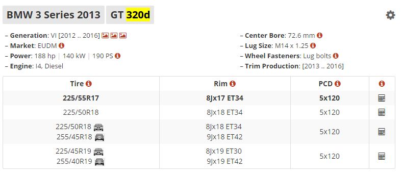

madxface: ďakujem, tú tabuľku máš odkiaľ?

tiboro2007 napísal:
napr.
https://www.wheel-size.com/size/bmw/3-s ... -320d-eudm
http://www.wheelfitment.eu/car/BMW/3%20 ... 013%20-%20).html
