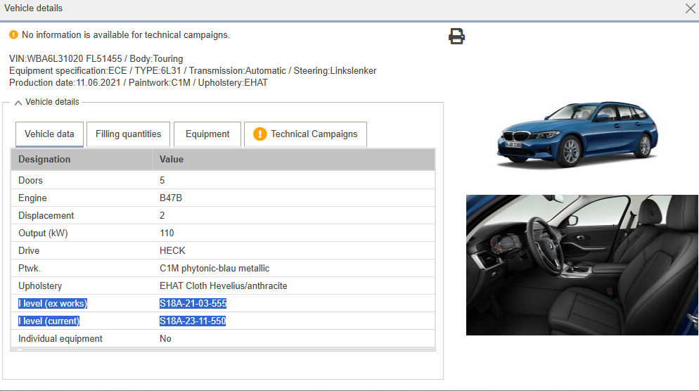

Here the correct P/N for your vehicle, as well as current version of i-level

Thanks for this. Looks like BMW in meantime updated sensor (or at least P/N so you cannot order it from normal parts store, thanks BMW for respecting "right to repair")
Changed sensor to: 13628582026, so Bosch: 0 281 008 466. And it's the same Bosch number that I had mounted, so I should be fine... for another 150+kkm at least :D
After erasing error, (2bba00 - diesel particulate sensor temperature signal not plausible), starting car 3 times, nothing came up so sensor should be fine (if it would be totally wrong then it would throw error from cold engine even) but will see in couple of days. I have on Saturday a longer trip, so will see if error will be triggered again.
BTW: What is I level? Edit: a ok - got it.
I did updated software via MyBMW, so I have 11/2023.50 firmware now - whatever that does.
